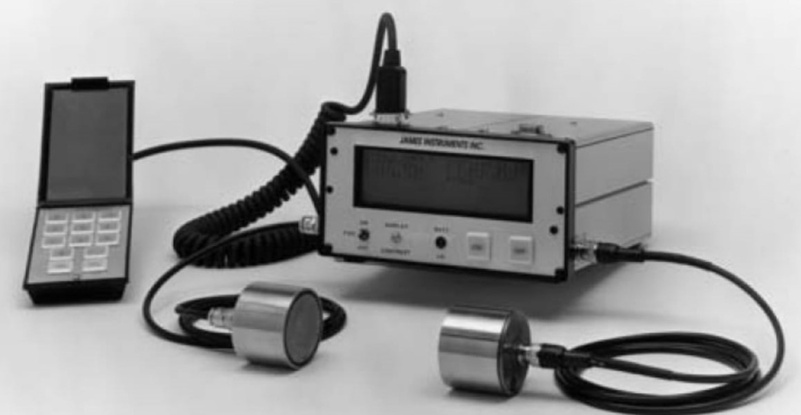

Apparatus: As per IS: 516(Part-5/Sec: 1):2018, Ultrasonic Pulse Velocity Testing, the apparatus for Ultrasonic Pulse Velocity measurement shall consist of the following:
1)     Electrical Pulse generator.
2)     Transducers- One pair.
3)     Standard Calibration Bar.
4)     Amplifier.
5)     Electronic Timing Device.
Piezoelectric and magneto-strictive type of transducers may be used, but magneto-strictive type is more suitable for the lower part of the frequency range. High frequency pulses have a well-defined onset but as they pass through the concrete, they become attenuated more rapidly than pulses of lower frequency. It is preferable to use high frequency transducers (60 KHZ to 200 KHZ) for short path length of around 50mm. The low frequency transducers (10 KHZ to 40 KHZ) are for long path length up to 15m (Maximum). Transducers with a frequency of 25KHZ to 100KHZ are found to be useful for most applications. The apparatus shall be capable of measuring transit times to an accuracy of ±1 percent over a range of 20 microseconds to 10 milliseconds.

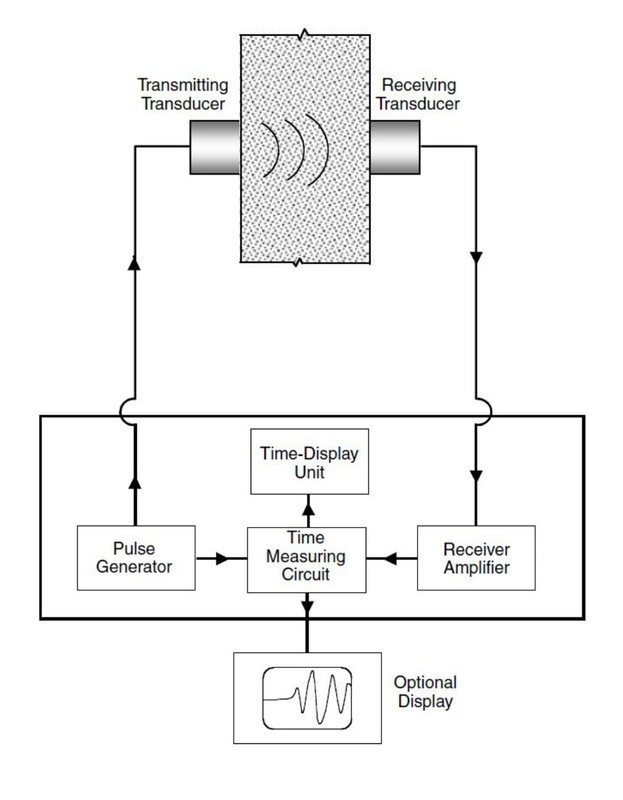

Determination of Pulse Velocity: The basic idea on which the pulse velocity method is established is that the velocity of a pulse of compressional waves through a medium depends on the elastic properties and density of the medium.
Fig-1: Pulse Velocity Instrument (Ref: 3)
Fig: 2: Schematic Diagram of Pulse Velocity Test Circuit (Ref: 3)
The transmitting transducer of the pulse velocity instrument transmits a wave into the concrete and the receiving transducer, at a distance L, receives the pulse through the concrete at another point. The pulse velocity instrument “DISPLAY” indicates the transit time “T”, it takes for the compressional wave pulse to travel through the concrete. The compressional wave pulse velocity “V”, therefore is V=L/T. The compressional pulse transmitted through the concrete undergoes scattering at various aggregate mortar boundaries. By the time the pulse reaches the receiving transducer, it becomes transformed into a complex wave form, which contains multiply reflected compressional waves and shear waves. Of course, compression waves travelling the fastest arrive first at the receiver.

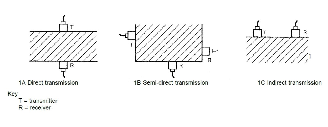

Transducers arrangement: When two transducers are placed on opposite faces of the specimen, the maximum energy is propagated and it is called “DIRECT TRANSMISSION”. When two transducers are placed on adjacent faces, it is called “SEMI-DIRECT TRANSMISSION”. When two transducers are placed on the same face, it is called “INDIRECT OR SURFACE TRANSMISSION”.
Fig: 3: Positioning of Transducers {Ref: 1)
The indirect transmission arrangement is the least sensitive and is used when only one face of the concrete is accessible or when the quality of the surface concrete relative to the overall quality is of interest. The semi-direct transmission arrangement is used when the direct arrangement cannot be used, for example at the corners of structures.
The above three methods have been defined in IS: 516 (Part 5/ Sec 1} 2018, Ultrasonic Pulse Velocity Testing. But in addition to above, BS EN 12504-4, 2021, Determination of Ultrasonic Pulse Velocity Test (British Standard) describes another method which is called “PULSE-ECHO TRANSMISSION”. This method like indirect transmission is used only when single face of the specimen is available. But this method uses only one transducer both for transmitting and receiving. In this case of Pulse-Echo transmission, the receiver detects pulses which have travelled through the concrete to the opposite surface and have been reflected back to the first surface. The sensitivity of this test is comparable with “Direct Transmission”.

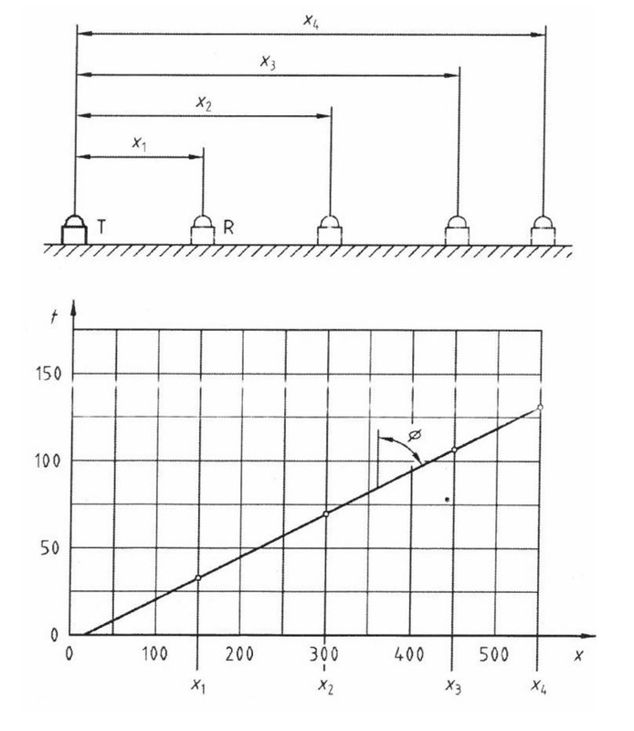

Determination of pulse velocity-Indirect Transmission: With indirect transmission, there is some uncertainty regarding the exact length of the transmission path because of the significant size of the areas of contact between the transducers and the concrete. It is preferable to make a series of measurements with transducers at different distances apart to eliminate this uncertainty. To do this, the transmitting transducer shall be placed in contract with concrete surface at a fixed point and the receiving transducers shall be placed at fixed increments Xn along a chosen line on the surface. The transmission times recorded shall be plotted as points on a graph showing their relation to the distance separating the transducers. The slope of the best straight line drawn through the point (1/tanØ) shall be measured and recorded as the mean pulse velocity along the selected line on the concrete surface where the points measured and recorded in this way indicate a discontinuity, it is likely that a surface crack or surface layer of inferior quality is present and a velocity measured in such an instance is unreliable.
Figure-4: Example of determination of Pulse Velocity by Indirect (Surface) transmission (Ref-2)
R= Receiver Transducer.
T= Transmitter Transducer.
t = Transit Time.
X1= Distance between transmitter and receiver transducer.
As per IS: 516 (Part 5/Sec-1): 2018, Ultrasonic Pulse Velocity Testing, surface probing in general gives lower pulse velocity than in case of cross probing and depending on number of parameters, the difference could be of the order of about 0.5 Km/s. In view of this, it is recommended that in surface probing method the pulse velocity may be increased by 0.5 Km/s, for values ≥ 3.0 Km/s.

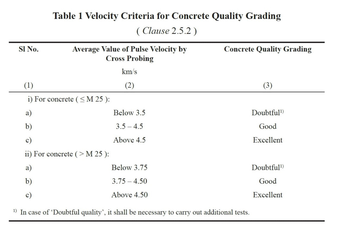

Point of Discussion: As per IS: 516 (Part 5/Sec-1): 2018, Ultrasonic Pulse Velocity Testing, concrete quality grading has been divided into three categories:
1)     Excellent
2)     Good
3)     Doubtful.
The code says that in case of “Doubtful Quality”, it shall be necessary to carry out additional tests.
From the above, can it be inferred that the concrete quality grading of “Excellent” and “Good” may not require any structural intervention and attention shall be paid only to Concrete Quality Grading of “Doubtful Category”?

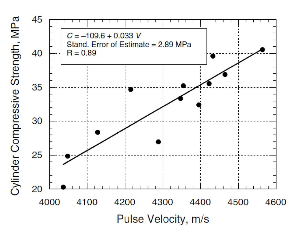

USE OF UPV FOR ESTIMATING THE CONCRETE STRENGTH.
Stipulations of IS: 516 (Part 5/Sec1) have already been stated in the body of above write-up. (Kindly see the heading in Bold- “Correlation between Pulse Velocity and Compressive Strength”). Therefore, let us, now, explore what are the options available in other publications.
1)     Provisions in ACI 228.1R-03, In-place Methods to Estimate Concrete Strength, Reported by ACI Committee 228.
This publication starts with basic premises that the Pulse Velocity is proportional to square root of Elastic Modulus. Because the Elastic Modulus and strength of a given concrete increase with maturity, it follows that Pulse Velocity may provide a means of estimating strength of Concrete, even though there is no physical relationship between these two properties. As Concrete matures, however, the elastic modulus and compressive strength increase at different rates. At early maturities, the elastic modulus increases at a higher rate than strength, and at later maturities, the Elastic Modulus increases at a lower rate. As a result, over wide range of maturity, the relationship between Compressive Strength and Pulse Velocity is highly Non-linear. Further, ACI 228-1R-03 has provided a figure showing a typical relationship between Compressive Strength and Pulse Velocity, stating that it is only an illustrative example and the actual relationship depends on the specific Concrete mixture.
The code concludes by stating that Pulse Velocity con be used to estimate strength in new and existing structure.
Fig-A Schematic of typical relationship between Pulse Velocity and Compressive Strength of a given Concrete mixture. (Ref: ACI 228.1R-03)
2)     Provisions in ASTM, C597-22, Standard Test Method for Ultrasonic Pulse Velocity through Concrete.
This publication states that if circumstances warrant a Velocity-Strength relationship may be established by the determination of Ultra Sonic Pulse velocity and Compressive Strength on a number of specimens of a concrete. This relationship may serve as a basis for the estimation of strength by further pulse velocity tests on that Concrete. It is further stated to refer ACI: 228.1R4 for guidance on procedure for developing and using such a relationship.

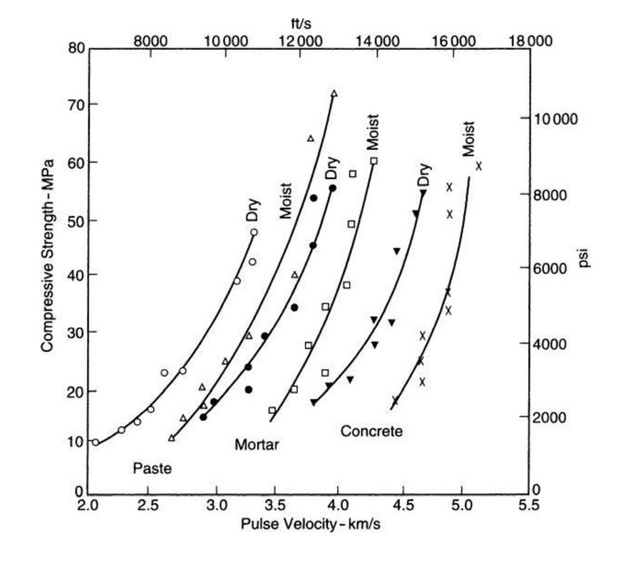

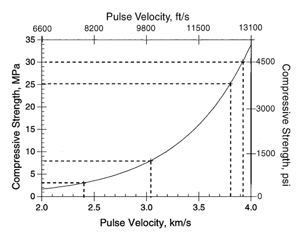

3)     Provisions in the article “The Ultrasonic Pulse Velocity Method by Tarun R. Naik, V.Mohan Malhotra and John S. Popovics published in HANDBOOK ON NONDESTRUCTIVE TESTING OF CONCRETE edited by V.M.Malhotra and N.J.Carino.
The above article states that the Pulse Velocity method may provide a means of estimating the strength of both in-situ and precast concrete although there is no physical relation between strength and velocity. The strength can be estimated from the Pulse Velocity by a pre-established graphical correlation between the two parameters. A figure has been provided there to as an example.
Fig-B Example Strength vs. Velocity relationship for estimation of Strength of Concrete.
This publication also talks about an article naming “Development of Statistical Quality Assurance Criterion for Concrete using Ultrasonic Pulse Velocity Method by K.K.Phoon, T.H.Wee, and C.S. Loi published in ACI Materials Journal/ September-October 1999. (This article is attached for reference.) This article proposes, including a worked out example, a probabilistic model to predict compressive strength from Ultrasonic Pulse Velocity.
4)     Provisions in book by A.M. Neville, Properties of Concrete.

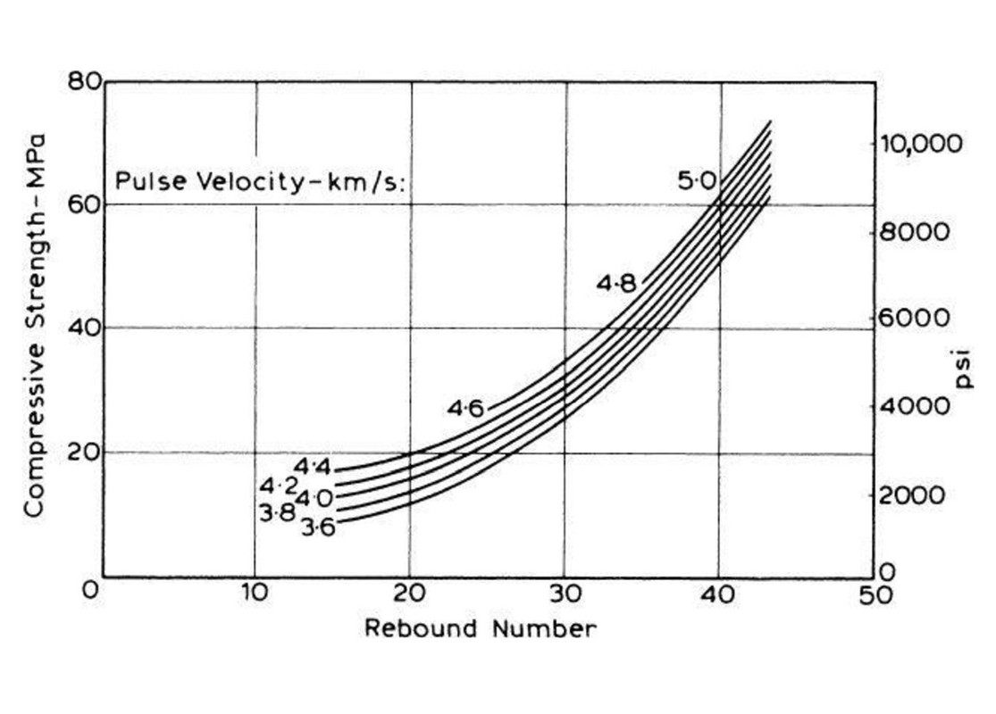

This publication states that no unique relation between Ultrasonic Pulse Velocity and Compressive Strength exists. It further states that the Ultrasonic Wave Velocity is related to the density of Concrete. This relation offers rationale for the use of the ultrasonic wave velocity measurements for the purpose of assessing the strength of concrete, but subjected to strict limitations viz changes in hardness of cement paste, change in water/cement ratio, moisture condition of concrete, presence of reinforcement, etc. This publication provides two important figures. The first figure is about relation between compressive strength and ultrasonic pulse velocity for hardened cement, mortar and concrete in dry and moist condition, which is taken from ACI SP-82.
The second figure provides curves for assessment of the in-situ compressive strength of concrete using the combined ultrasonic pulse velocity and rebound hammer tests.
Fig-C Relation between Compressive Strength and Ultrasonic Pulse Velocity for hardened Cement paste, mortar and Concrete in dry and moist condition.
Fig-D Curves for assessment of in-situ Compressive Strength of Concrete using the combined Ultrasonic Pulse Velocity and Rebound Hammer Tests.
